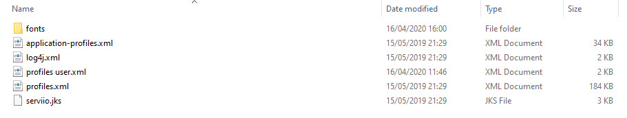

The file you kindly provided didn't allow Serviio to work, probably due to my limited knowledge of the file naming conventions.
I tried the following:
Rename LIB folder file 'profiles.xml' to 'profiles orig.xml'
Copy the file 'user-profiles.xlm' to LIB folder.
Rename the file 'user-profiles.xlm' to 'profiles.xlm'
Serviio wont open: stuck on 'Serviio-Console-Wrapper' and states 'Cannot connect to the server, it doesn't appear to be running...'
Reboot PC.
Copy contents of 'user-profiles.xlm' and add Panasonic TV (GZ-series) to 'profiles.xlm'.
Reboot PC.
Edit the new 'profiles.xml' file to follow the format of the other devices: success! Measure twice, cut once!

No, you don't replace the existing profiles.xml file at all. Leave it in place, and just put the user-profiles.xml file in the same folder. The original file is required for Serviio to work. The User-profiles file is an add-on, and is not touched when Serviio is updated.

My apologies again, but I am not familiar with how Serviio uses the profiles, and as your recommendation did not work, tried a method that does appear to work.
Leaving it in place as well as the original profile means the GZ option as you suggest means it is not listed and hence is not selectable (after reboot). See attachments.
Given that my method appears to work, all I need now is a way for the video files to be left alone and not upsized.
