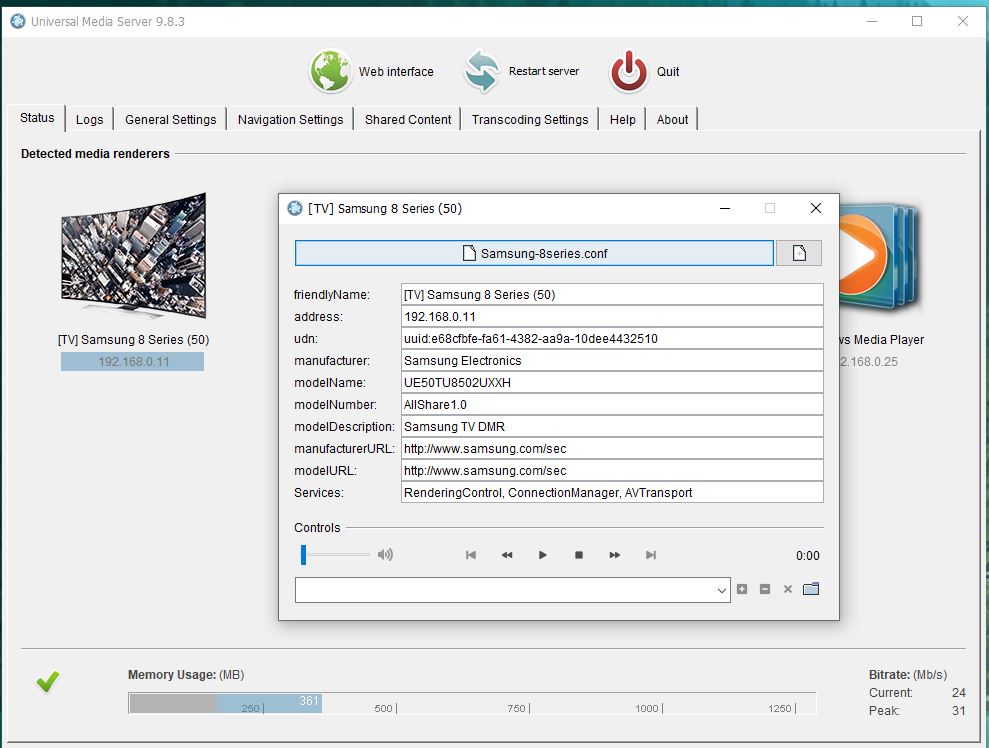

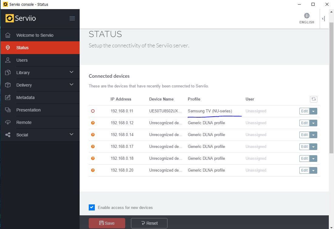

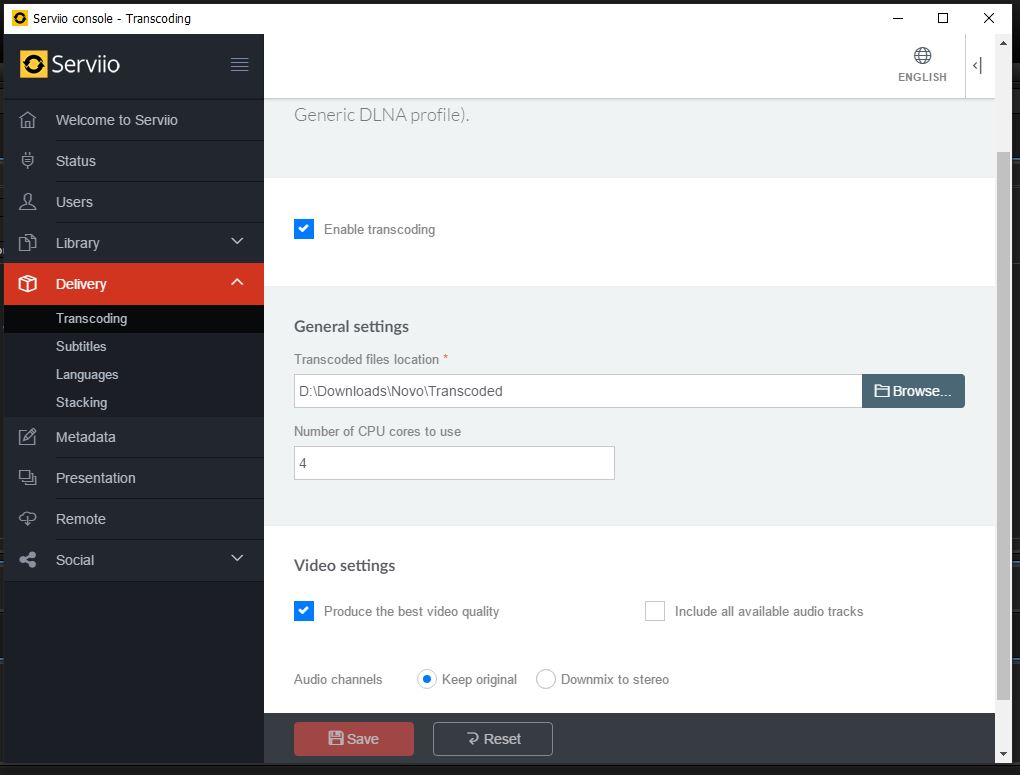

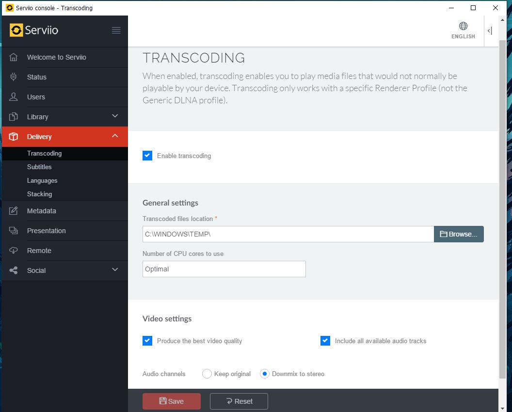

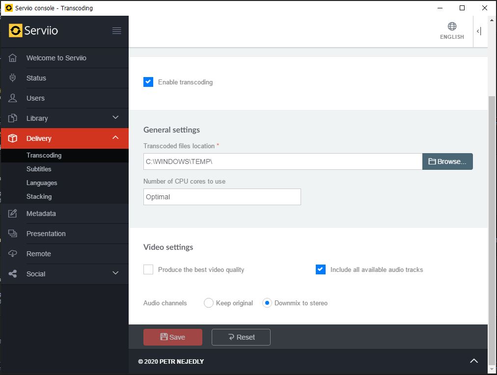

Here is screenshots (NU profile, transcoding) from serviio settings .
I have just tried UMS (Universal Media Server) and dts converted to ac3 by default.
here is UMS log file.
I want to use serviio , because I like it, and user interface is better than UMS.

After everything I have tried, I did not find yet, why Serviio 2.1 not want to transcode mkv file with dts audio .
Yes, I have entered path to transcoded folder, but nothing there during playing movie. The folder is empty.
