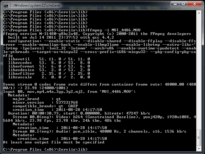

I am having problems playing MOV files from my Samsung LED TV UN46D5500 I just bought. The MOV files were recorded by my Canon DSLR. I am using latest version of Serviio and I am running it on my PC with Windows 7. I have assigned the "Samsung TV/player C/D series" profile from the Serviio console

Also I am attaching a screenshot of ffmpeg output and the serviio.log with DEBUG enabled. The file that I am trying to watch from my TV is called MVI_4486.MOV
I am getting the message "wrong video codec" on my TV.
Can you help me to get it to work? Your help will be greatly appreciated

weird, it transcodes to mpeg2 correctly. Run this command and then add the resulting file to your library and try to play it (natively)
ffmpeg.exe -i "D:\My Files\My Pictures\2011-08-28\MVI_4486.MOV" -y -threads 1 -vcodec mpeg2video -sameq -r 24000/1001 -g 15 -copyts -acodec ac3 -ab 192k -ar 48000 -ac 2 -map 0:0 -map 0:1 -sn -f mpegts C:\out.mpg

I tried your suggestion of transcoding the video offline and strangely enough I can see the generated file on my tv! One strange thing are the error messages I got from ffmpeg. Here is the log I captured;
ffmpeg.log
(9.11 KiB) Downloaded 717 times
The errors are:
1) Incompatible pixel format 'yuvj420p' for codec 'mpeg2video', auto-selecting form at 'yuv420p'
2) [ac3 @ 03a16100] channel_layout not specified
[ac3 @ 03a16100] No channel layout specified. The encoder will guess the layout,
but it might be incorrect.
Anyways it seems to work in the offline mode. Any suggestions on how to do it online, i.e., not having to transcode all my movies on my hard drive to be able to watch them on my tv?
Once again thanks a lot for your help
Pablo
