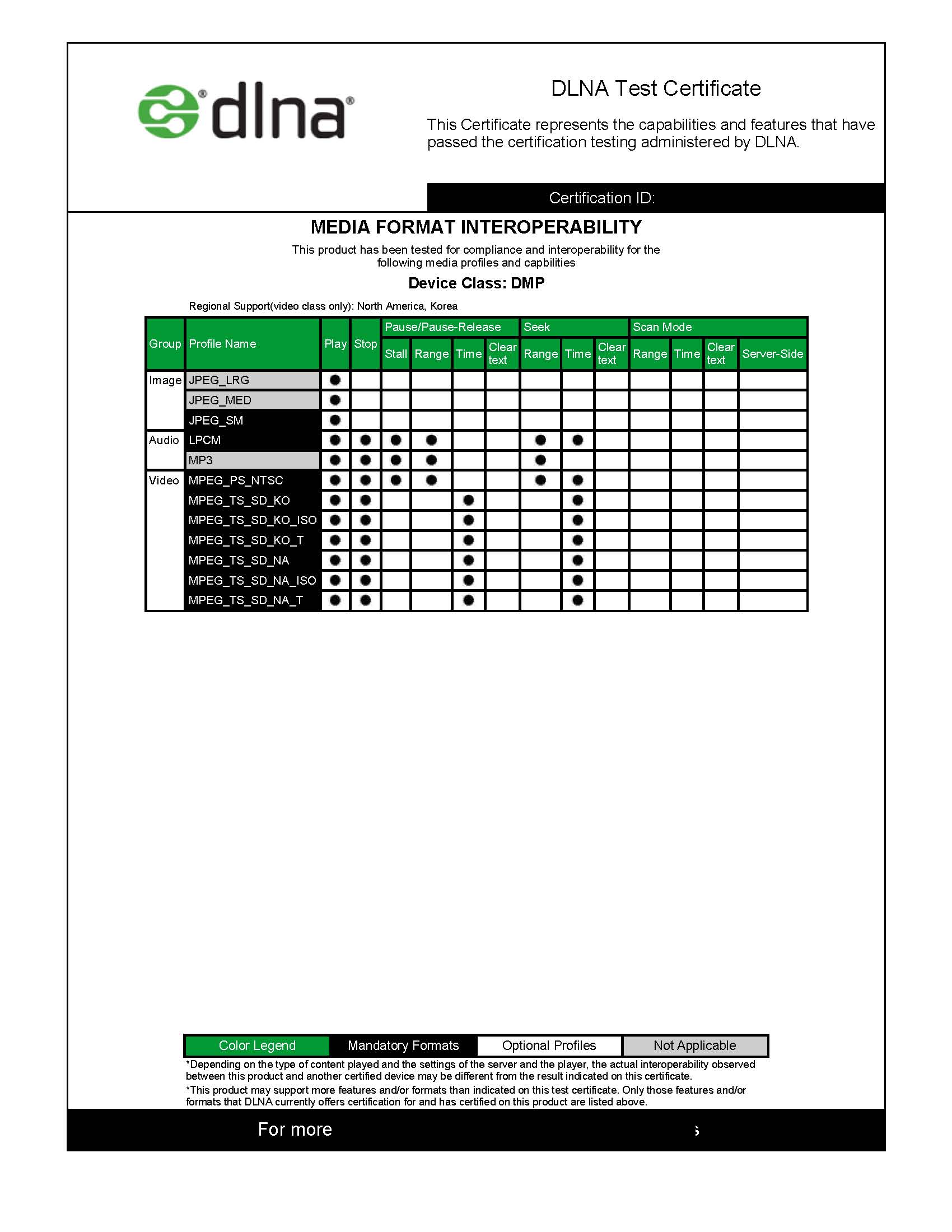

That is true for european models. Here is the DLNA certificate for my model. I wish I could generate a sink file, but the tool doesn't find my TV.
DLNA cert
Post Wed Sep 22, 2010 2:43 pm
Re: AVC_TS_MP_HD_AC3 vs. MPEG_TS_HD_NA
Ahh, damn. In that case the profile that Illico provided should be working.
