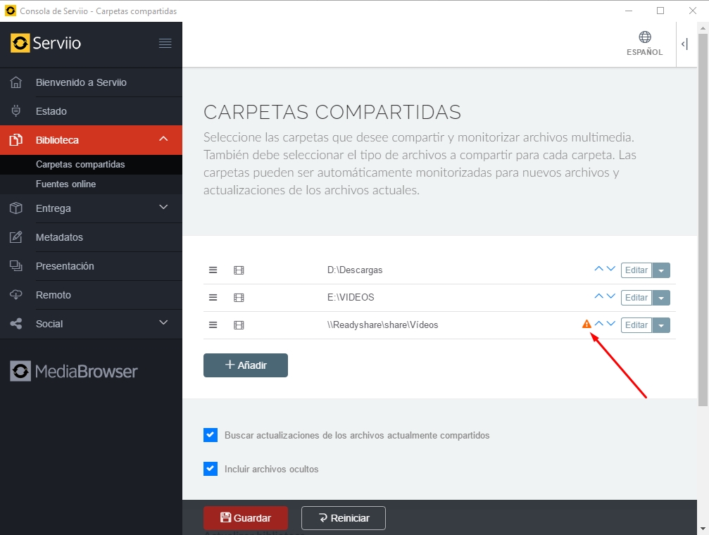

Hi, I have a new 4TB HDD, formated with GPT 4TB NTFS partition conected with usb 3.0 to router.
When i add the LAN Adress "\\Readyshare\share\Vídeos" and search content, i get this:

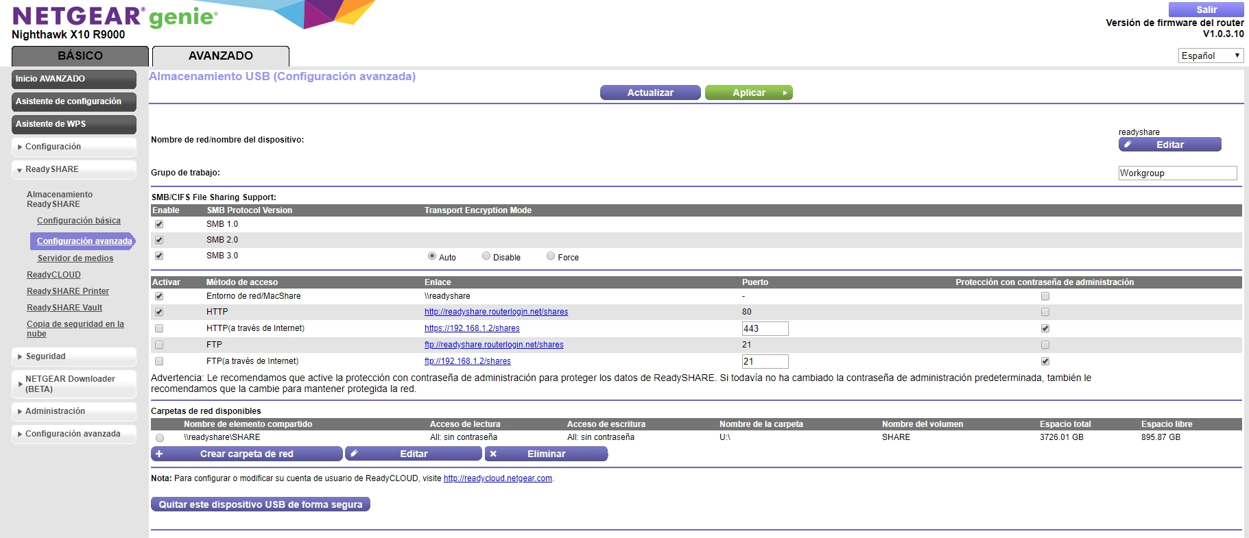

This is my router:
https://www.netgear.com/landings/ad7200/
This is the configuration of the LAN Folder:
I can access to this LAN folder from all my devices, computers, phones, TV without problems.

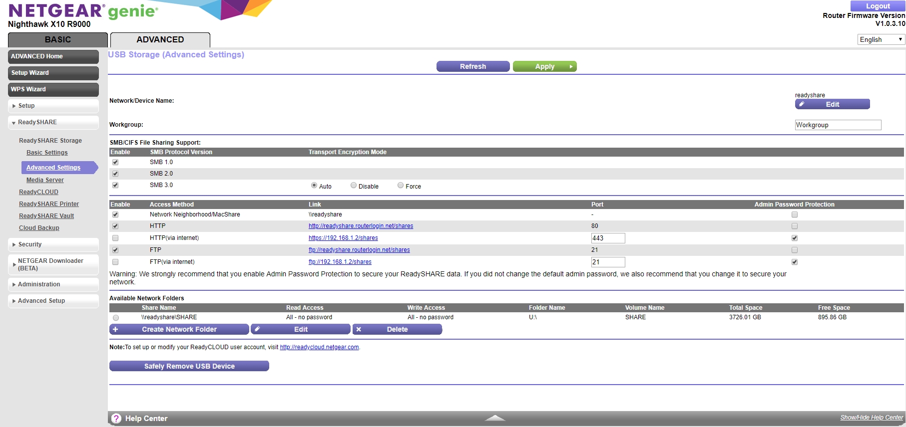

Sorry, i put the configuration in english:
I configurate the access to lan hdd without password or any porotection, before i change hdd 2TB with same router my serviio can read all videos on lan drive, my problem was when i change the HDD for a 4TB.
