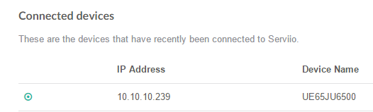

Issue: Serviio stopped working after upgrading from Windows Server 2012 R2 to Windows Server 2016 -- Console shows TV is connected, however TV does not see Serviio anymore (no source icon on TV).

Thank you for a tip. However, re-install does not help. Moreover, a completely fresh install on other server with Win2016 behaves the same -- Serviio console shows the device, but it does not appear on TV Sources... I think, that is related to OS -- any other advises, please? Thanks.

Well, now I'm baffled. I see the IP address of the TV is in the same address range, so there's likely no issues there. I'm at a loss.
