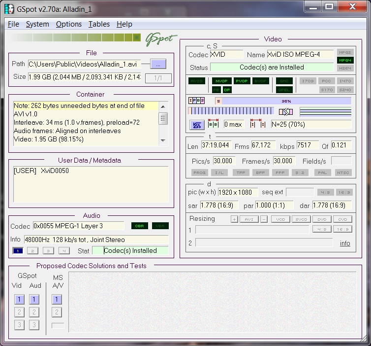

GSpot returns the following data for the file:
GSpot Output for the .avi file

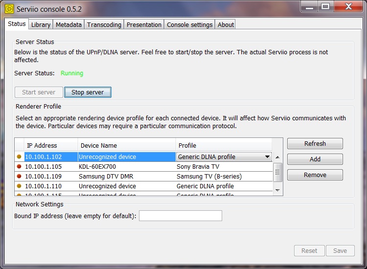

Serviio Console for the devices identified and their profiles (I had to change the Samsung profile from Generic DLNA to Samsung TV (B Series)

this is a normal divx video and should play. Must be the software you're using. You could set up a trasncoding of mp3 to ac3 to fix this, but it's a bit rubbish ;-/
