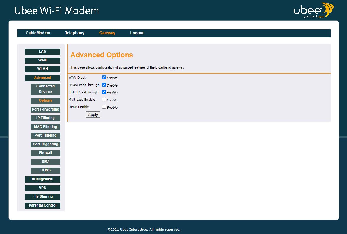

Browsing through the Forum, I've found that this may be connected to Multicast/IGMP settings on the router. The only options I see on my router interface are "Multicast enable" and "UPnP ENable" and by default, the both were on. When I switch them off, the issue persists, only in that case the break comes after about 5 minutes, instead of the 2 or 3 with the features on.

Router settings with MC off
Router settings with MC on

Yeah, really sounds like something external to your Serviio computer. Perhaps your router updated its firmware, and some setting was changed. Make sure any uPNP setting is enabled. Other than that, I'm drawing a blank.
