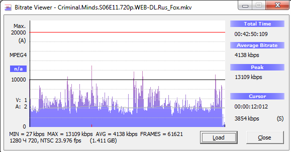

Hi guys,
I'm running Serviio 0.5.1 with Samsung TV (B-series) profile. TV connected over wired network. Transcoding is enabled. TV says that video not supported. Mediainfo and bitrateviewer logs are attached.
It looks like I need to transcode this video but I dont know that setting should be used.

gegMopo3 wrote:... TV says that video not supported. Mediainfo and bitrateviewer logs are attached.
Thanks for that informations.
gegMopo3 wrote:Writing application : mkvmerge v4.4.0 ('Die Wiederkehr') сборка от Oct 31 2010 21:52:48
H264 profile/level seems compatible, bitrate too. With mkvmerge you could have some problem with "header compression" feature.
Could you provide mkvinfo result of your file?
You could also check that viewtopic.php?f=6&t=1132#p5402 .

Thank you for the reply. My MKVs have header removal feature enabled. Your solution works fine but audio was still unavailable. I've removed compression for it and now everything OK.
Thanks again :)
