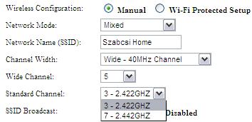

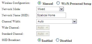

Illico wrote::idea: Change the channel of your Wireless-N WRT160NL router.
Thanks, wich 1 did you mean :?:
(see attachments)
Basic Wireless Settings
Basic Wireless Settings.JPG (11.25 KiB) Viewed 16307 times
Advanced Wireless Settings
Advanced Wireless Settings.JPG (23.97 KiB) Viewed 16307 times
Post Thu Nov 03, 2011 9:59 am
Re: Samsung UE40D6100 disconnects and cant re connect
http://netlink.com.ua/media/products/01 ... 076662.pdf
Page 10.
Try change Channel Width with "Wide - 40MHz Channel" or "Standard - 20MHz Channel."
I changed it this way, after i go home i will try it. Hope it helps.
Thanks anyways :)
Basic
Basic Wireless Settings.JPG (12.65 KiB) Viewed 16299 times

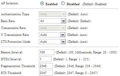

If I see correctly "AP isolation" is enabled. You should disable it (as by default) because with this option enabled your network devices cannot see each other (no homegroup, no communication between devices, no nothing, except access to internet for all devices).
Hope this helps.

YTMY wrote:
ratyip4 wrote:Any1 other ideas :?: :roll:
Hope this helps.
Nope, i have set it to disabled, and now cant even se serviio :x
Thanks anyways

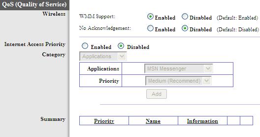

Try'd to turn off firewall also (Windows 7 and ESET 5 also).
Well this is my 4. router this year :D and wasnt cheap, so i try to borrow one...
My last try will be to reinstall the windows, but Serviio can detect my TV, status green on the main page, but after i hit refresh, i still cant see Serviio on my TV :( )
QoS settings below:
QoS settings
