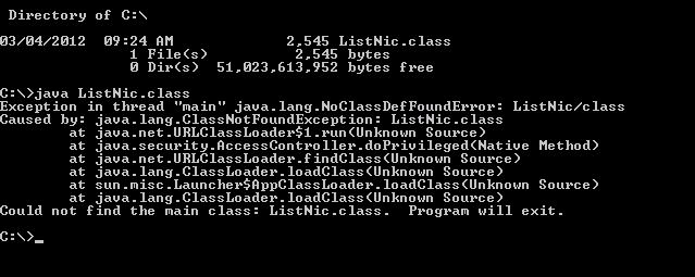

See attachment. Once I had my to the bound section, it appears to be working. I'm not sure I ran the listnic.class correctly. The screenshot should tell you. Thanks for the help.
Post Fri Mar 09, 2012 8:42 pm
Re: Problems with Samsung 6300C connecting to Serviio
just type
java ListNic
without the .class
