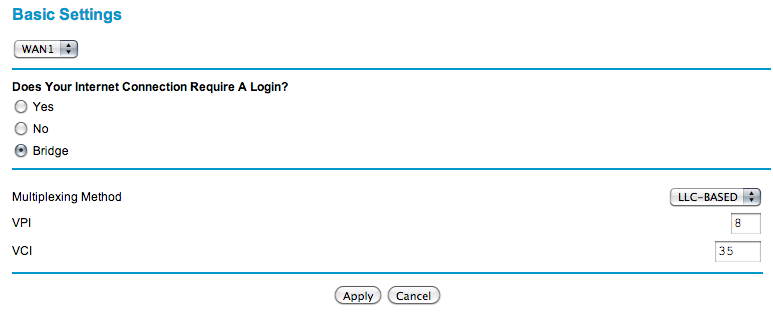

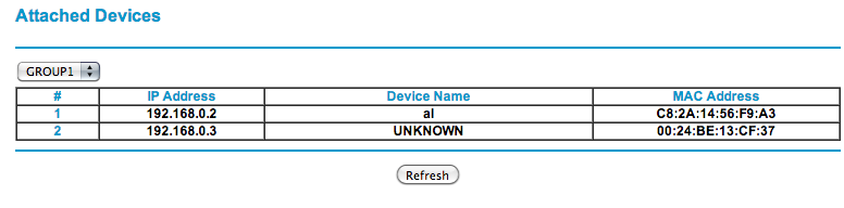

Ok, so still no luck. Here are the settings of the DVG 1000 that I have connected to my computer and TV.
The computer is al and has the IP address of 192.168.0.2 and I'm guess ing 192.168.0.3 is the TV?
Does the IP address of the other modem that's attached to the internet matter in all of this? Seeing as it's not on the same network it shouldn't be anything to do with this... Correct me if I'm wrong?
Thanks again-

OK, I am still not following something. Is there any connection between the D-Link and the Netgear? If so, then yes they are one the same network and the IP address does matter. They may be different segments, but certainly should be assigned IP addresses within the same subnet.
This is how I think your setup show go, but again I'm making some assumptions here. All devices with an IP address set manually should have a netmask of 255.255.255.0 .
The D-Link should be your primary router for the network. It should have an IP address of 192.168.0.1, and should be assigning IP addresses beginning with 192.168.0.10. You can set the address range in the D-Link DHCP settings. Make sure the correct netmask is being assigned as well.
There should be a Ethernet cable connecting the D-Link to the Netgear. This would plug into the "Internet" port on the Netgear. If this is impossible to do, then the Netgear should wirelessly connect to the D-Link as a bridge (as you appear to have done). The Netgear should have an IP address of 192.168.0.2. Make sure the Netgear has DHCP disabled, although selecting Bridge should do that automatically. Being in Bridge mode should pass everything between the two segments.
All other devices (Mac, TV, etc.) should get their IP address from the network DHCP device, which should be the D-Link. Verify that they have been assigned an address that is 192.168.0.10 or higher.
Why start the address range at .10? This leaves you some room for devices that you might wish to assign an IP address, without interfering with the DHCP range.
From the Mac, you should be able to ping any other device on the network. If the ping fails, then there is a definite issue with your IP addressing and router configurations.

OK, let's disregard the D-Link completely. It won't be part of the network that Serviio is on.
What it sounds like you are describing is a complete, isolated network, with no inter-connectivity with anything. This means of course that the Mac can't see the Internet either. You have the Netgear in bridge mode. This means you are using it for two purposes: a wireless access point for the TV and a switch that the Mac plugs into. Now, there is nothing on the network that is providing IP addresses (no DHCP). This requires setting static IP addresses in each device. I suggest using a different IP address range for the Mac, Netgear and TV from your D-Link network. This way, you could add another network adapter to the Mac (USB dongle perhaps) and have the Mac connected to both networks and be able to access the Internet. But leave that idea alone for now, until you have everything working first.
Set the IP address of the Netgear to 192.168.1.1 (note the slight change from the D-Link network). Use the same netmask (255.255.255.0). Set the Mac to .2, and the TV to .3. Of course, the TV must be connected to the Netgear, either wireless or Ethernet cable. These three devices should now be able to talk to each other, and Serviio should be available on the TV.

Cant help but think it may be easier to start again and that you'd be better not using bridge mode at all (bridges can be a pita if you're not network savvy):
  • Login to your Netgear Router and do a factory rest;
  • Connect back into the Netgear Router, and go to LAN settings. Set your routers IP address to be 192.168.10.1 - the DHCP settings should automatically change to be 192.168.10.2 to 192.168.10.254. This will ensure that this networks IP address range does not conflict with your other (internet) network on the DLink router. Press apply - you may need to reboot the router for this to take effect.
  • Connect your TV's and any Macs to this network
This is all you should need to do. Your TV and Macs should be assigned a 192.168.10.XXX address from the Netgear (you don't need to assign their addresses or subnet masks) and it should all work. If it doesn't for whatever reason, turn off your DLink (just in case your Macs are inadvertently still connected to that - you can also tell by going to the internet - if connected to the Netgear they will not be able to access the net. If you can get to the internet it means they are still connected to the Dlink). Also, in Serviio console make sure you are bound to a 192.168.10.xxx address.
As I said it should work. If it still doesn't, go to the TV and to your Macs and check their network settings and find what IP address they have connected on - let us know. Also, did you clear all the ghost Serviio icons from the TV (clear the server list in the TV's Network menu).
ps. having two networks like this is a pain - while the TV will remain connected to the Netgear network, the MAC's will need to connect to the DLink (in the last post you mentioned a Belkin instead?) network when accessing the internet, and to the Netgear network when acting as a Serviio server (and if they get wireless connectivity from both you may have problems...). A better approach would be to have one network - why have you done it this way? Why not run everything off the Dlink/Belkin as a single network? If its simply that the Tv is too far away from the internet Dlink --> then there are also ways to make the Netgear effectively a slave off the Dlink rather than have it as a separate network.
