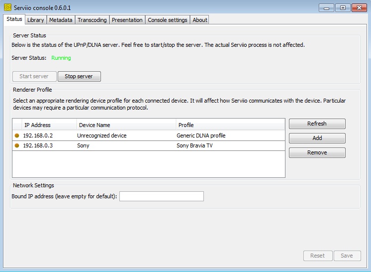

Well yes, i have Ethernet cable, and I hope i have everything done properly, so my network connection has been set to tcp\ip v6 off, v4 on, ip 169.254.101.32, subnet mask 255.255.0.0, gateway - automatic. TV shows that his ip is 169.254.101.33, so there is a 1 number difference between them, and subnet and gateway are set automaticly...
in the serviio i have something like this

Sorry if i missed it, to what do i have to change it? in the renderer menu, automatic is on, smart select on, renderer name is BRAVIA KDL-40EX503
in serviio i have deleted old data, added a bravia with ip that is shown in the TV menu, it is 192.168.0.3, however it shows another dlna device, dont know what it is..
i have also updated my tv firmware to the latest one

bugs wrote:in serviio i have deleted old data, added a bravia with ip that is shown in the TV menu, it is 192.168.0.3, however it shows another dlna device, dont know what it is..
Why do you manually add the bravia?
Please remove all old data, save then restart serviio services (or restart your PC).
Then restart serviio console and press "refresh button".

What is the device with 192.168.0.2, your PC ? Do you change your IP address from your first post ? viewtopic.php?f=11&t=4052#p26583

now after some time it shows unrecognized device on 192.168.0.2
Re: Directly PC to Sony Bravia?
And what is this IP address? Sony ?
Could you in a windows terminal check your PC IP address ? (execute cmd, then type "ipconfig /all")
