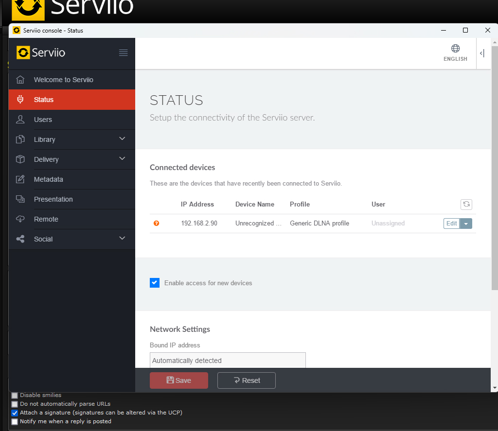

Sorry, just spotted that Servio was showing a 'bound IP' address of '192.168.2.90 (Realtek PCIe GbE Famiy Controller)'. I have changed this to 'Automatically detected' but Serviio is still not seeing my LG TV.

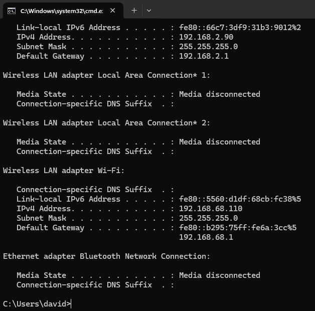

I have run IPCONFIG and have attached the result.

I have also attached a screenshot of Serviio which can see 192.168.2.90.

OK, IP settings all look fine. Strange that VLC would have a different UI on an Android device. I have it installed on my Nvidia Shield (which runs Android TV) and Network locations are listed there (certainly a different UI from a phone though). Across the bottom of VLC on my phone is Video, Audio, Playlist, Network, and Settings. Perhaps they moved those items somewhere else in the UI.
