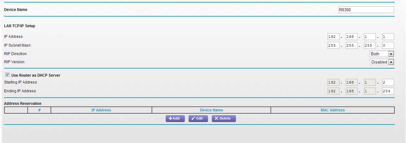

Sorry, I don't really understand how to do this. I'm attaching a screen shot of that screen...

The IP address of your Serviio server is 192.168.1.6 according to the IPCONFIG command.
To reserve addresses in your router, in that router screen, press the Add button in the bottom section. You can then select any connected (and switched on) device and assign a new IP address for it (must be 192.168.1.xxx). This address will then be used every time for that device (at the moment a different one can be assigned each time).
For example, you could set your server to be 192.168.1.101 as you originally thought it was (and set your TVs at the same time). You need then to restart your tv and server for the new IPs to be assigned. Check with IPCONFIG, and once done bind Servio to the address using the one of the methods in my post above.

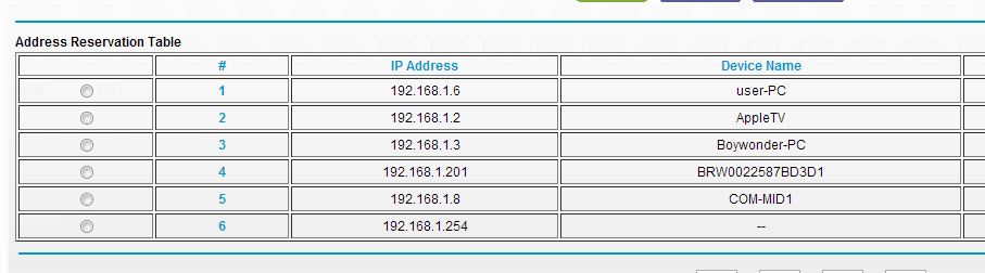

I'm probably being a moron about this, but 192.168.1.6 appears to already be assigned to my laptop (user-PC). Please see attached.

It's hard to tell where you're at but if its the screen I think it is these are yet to be reserved. Select one by checking the checkbox on the left and then enter the IP you want in the area below what you have shown.

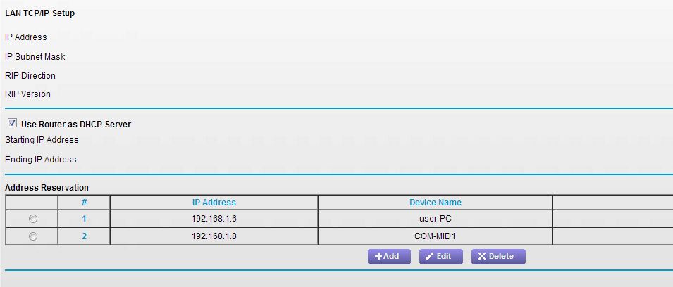

K, so here's a screen shot of the two reserved IP addresses, but now my only option in Serviio's Bound IP dropdown is "Automatically detected".
How is this even possible!!

Restart everything (TV, Router and Server)??

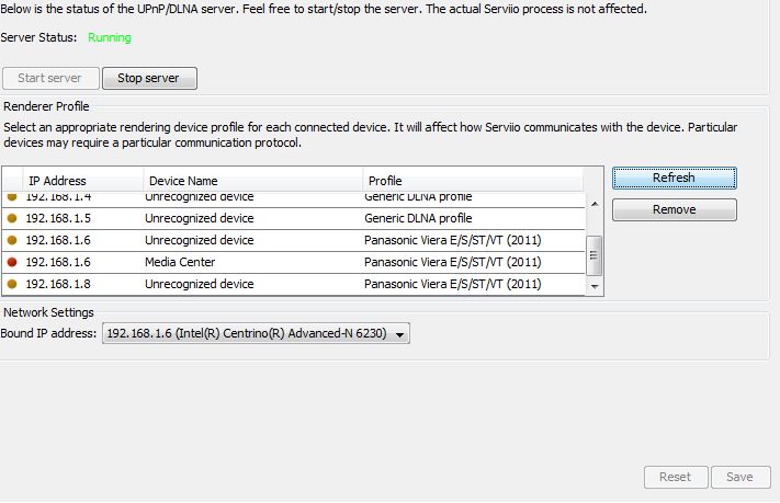

Reset all three devices. When I reload my laptop, it reverts back to Automatically detected, even though I saved it. I then switched it back, but to no avail.
Here's another screen shot of that page.

In your renderers list wherever you see the same IP address two or more times remove all of them, save and do a refresh. Your server, now on 192.168.1.6 should be found again - leave it as a generic profile.
Now that you have set your server address to 192.168.1.6 (and the TV to 192.168.1.8) did you remember to edit the ServiioService.exe.vmoptions file to reflect this address:
-Dserviio.boundAddr=192.168.1.6
Once done, restart Serviio - does the TV detected Serviio any better?

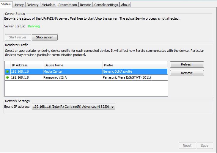

I think we're getting closer. Serviio now shows up on my tv's DLNA server screen - something it hasn't done in a few days. And my Status Page looks like the attached screen shot. Having said that, when I click on Serviio on the television, it says 'accessing', but then comes back as connection to server failed.

Do you have a firewall in between the TV and the Serviio laptop (e.g. on the laptop itself).
Try disabling it and check again.
I don't remember if you are on wired or wireless. If on wireless, try the wired option in case that is feasible.
