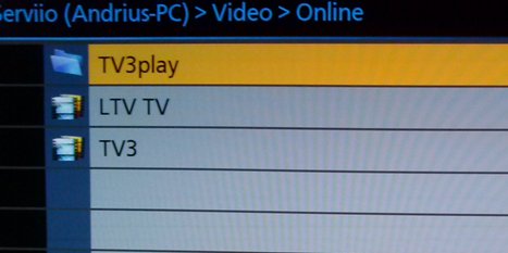

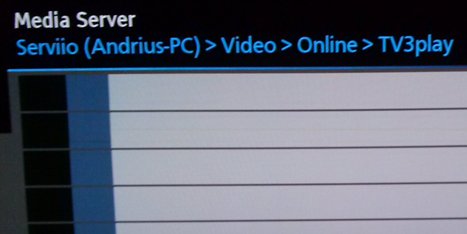

Hello, all,
I want have Lithuanian tv3play too.I added this plugin but without success. Then I changed my profile to Neoromancer's working profile and again without success.
Please see bellow:
1. As can be seen I have tv3play icon on my tv:
2. But tv3play is empty:
Please help me! If it helps I am using P42ST50E TV.
