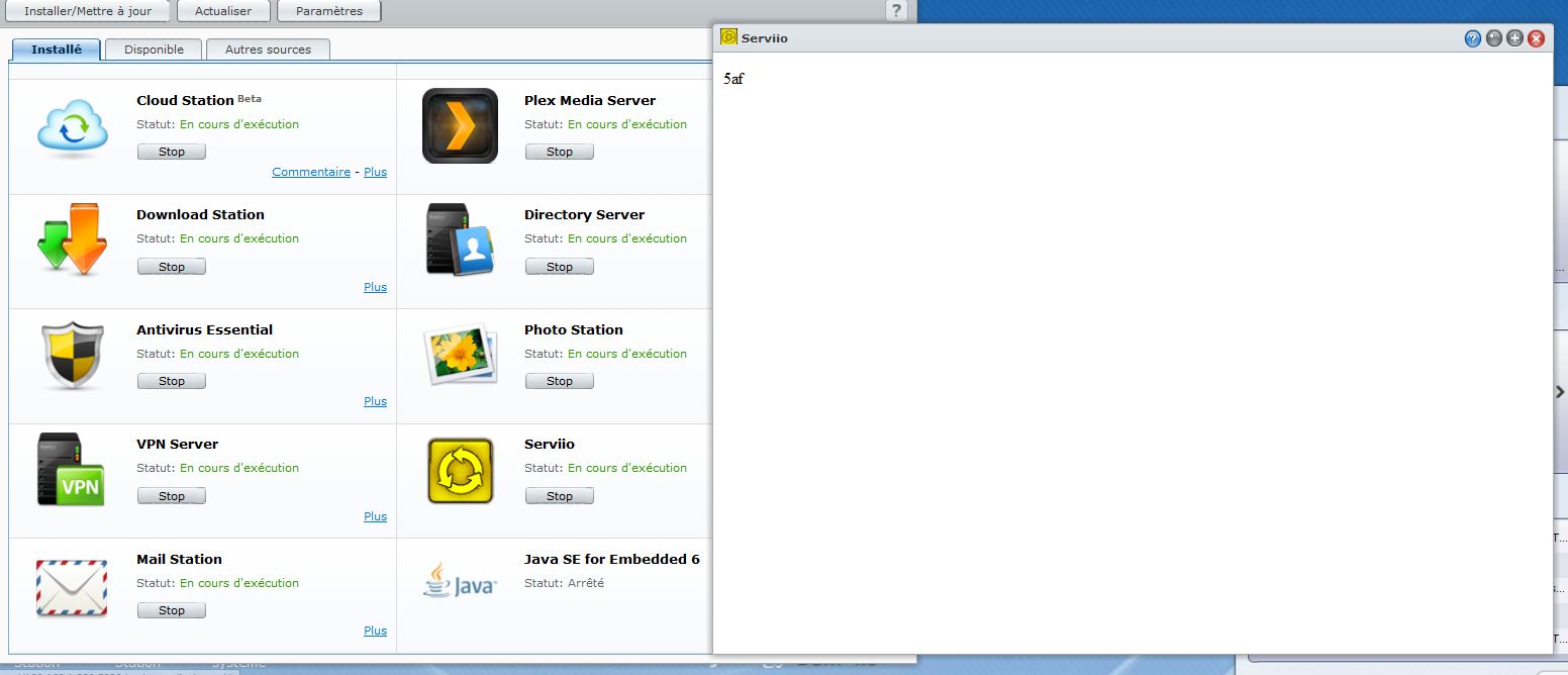

Post Tue May 15, 2012 2:09 am
Re: PACKAGE: Serviio 0.6.2 for Synolgy NAS (ARM & Intel)
Hello
I just installed serviio on my DS1512+ and when I click on serviio icon to start control pannel I got a white window with "5af" write on the upper left corner. (see print screen attached)
Someone can help me please?
thank you

Alaska99
Posts: 20
Joined: Tue May 15, 2012 2:00 am
Location: Québec
Post Thu Jul 12, 2012 8:30 pm
Someone try the new DSM 4.1 beta ? All folder with french character like "é" are not indexed and not displayed....

patters
Posts: 1282
Post Fri Jul 13, 2012 12:50 pm
Thanks for reporting that. I'll take a look.
patters
Posts: 1282
Post Fri Jul 13, 2012 1:09 pm
I forgot - you always need to stop Serviio, and reinstall my Java package if you've done a DSM upgrade. The Java package installs the Linux locale support which is missing in DSM (essential for UTF-8 character support in Java).
Alaska99
Posts: 20
Location: Québec
Post Fri Jul 13, 2012 9:05 pm
You're right!! Reinstall java and now all work fine!
Thank you so much!!
:D
