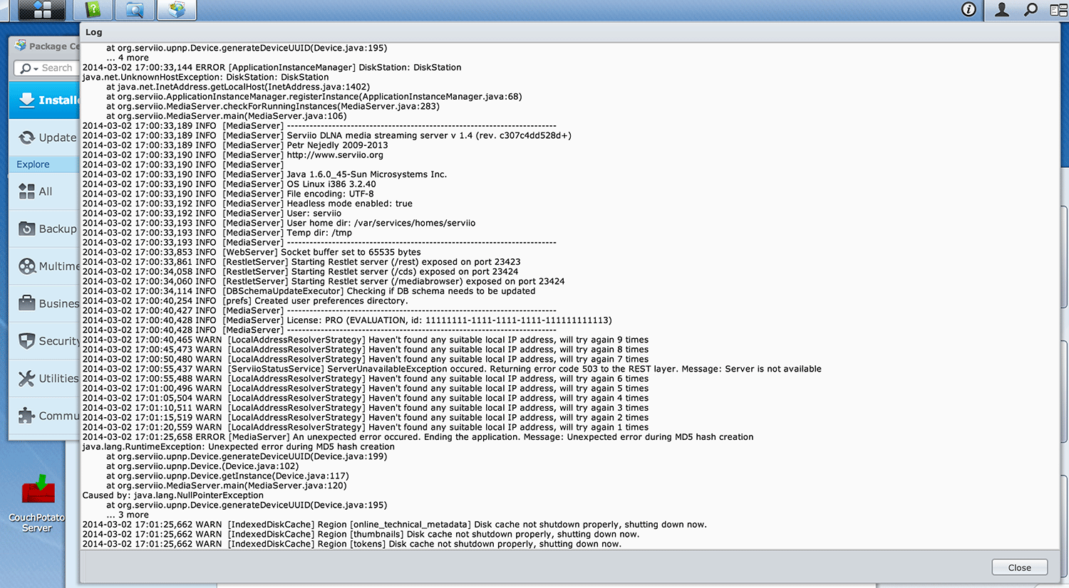

Because I have no idea on how to find/create a detailed log file on the Serviio that's running on Synology, I made a screenshot of the log-file through DSM. I've added it to this post.

Serviio doesn't appear to be finding an IP address - try setting your IP address using the serviio.boundAddr property (see http://www.serviio.org/component/conten ... properties and http://www.serviio.org/index.php?option ... e&id=21#q3).

I think the problem lies with the Serviio version that is installed on the Synology NAS DS214+. Because every time I try to restart that, it runs for a couple of seconds and then the server stops again, exactly like the first screenshot... Maybe I should update/change any files in there?

One other thing - I notice you are using Java 6.0.45 whereas patters is using 7.0.45 in his package (from the screen shot). Are you using patters' package (from http://pcloadletter.co.uk/2012/01/25/se ... o-package/)? If not, probably the path to go.

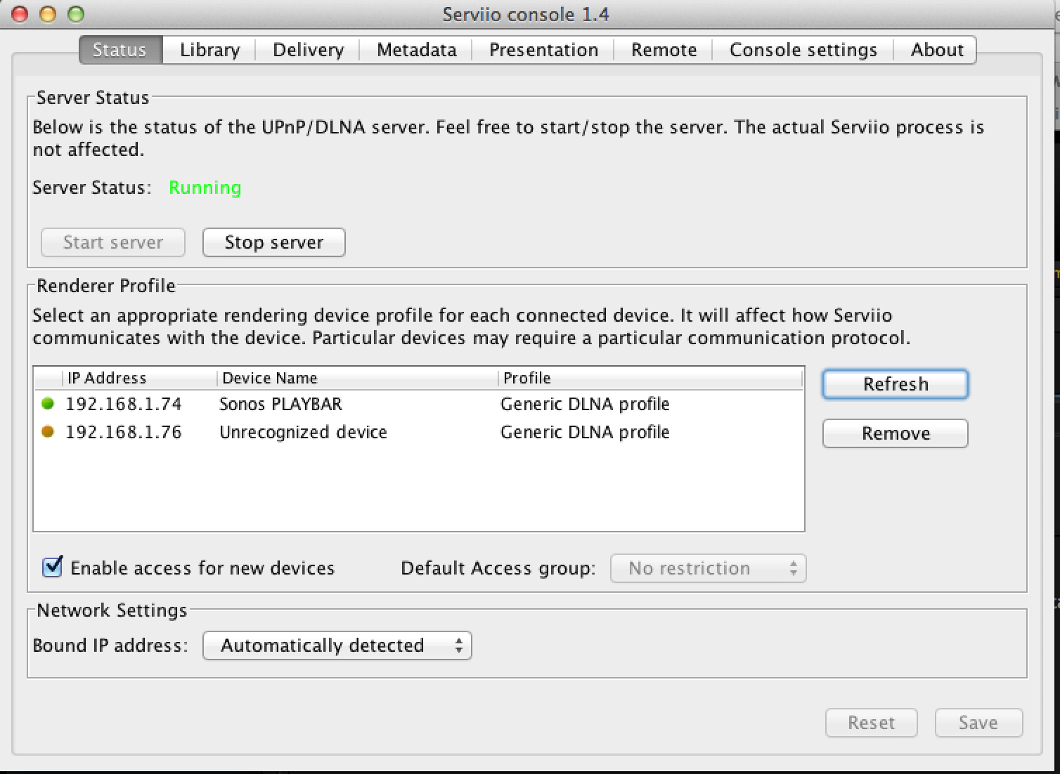

When I do a clean install of Serviio on my mac, without updating any info.plist files, it will start up (only the console). The Serviio app will tell me after half a minute that the application is not responding.
I've also added a screenshot.
The problem though is that my Synology NAS is connected through 192.168.1.75, and that one isn't in the list of 'rendered profiles', as you can see on the screenshot...
I hope this helps some.
