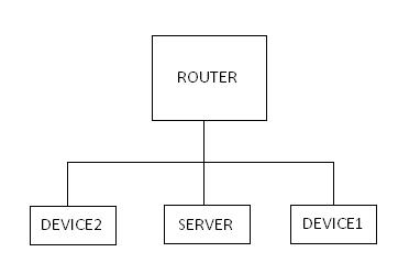

then we can try and work out whats happening. a connection tree might also be useful here so we know what is connected to what ( example one is included below ).
simple network tree.JPG (7.23 KiB) Viewed 7644 times
Straight line = wired connection
Dotted line = wireless connection
