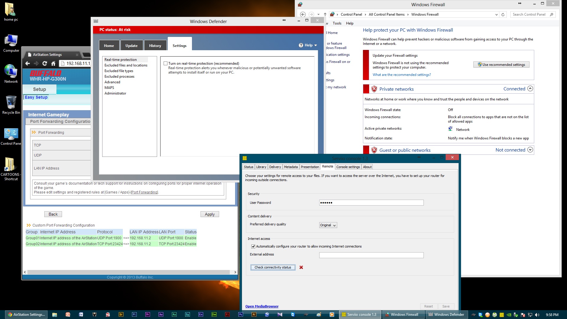

Hi, I just bought Serviio hoping to get the remote feature up and running but I'm having into a similar problem. http://www.canyouseeme.org indicates port 23424 is open but I still get the red X and:
INFO [PortMappingChecker] Running a check for external mapping of port 23424 on '142.166.159.148'
WARN [PortMappingChecker] Cannot work out whether port 23424 is open or closed
Here's an excerpt from the debug log:

I've been trying everything I can think of (disabling windows firewall, windows defender, spybot, avg) but no luck. Could Windows (7) be blocking Serviio some other way?
Post Sat Sep 14, 2013 8:55 am
Re: Remote stop working after reinstall of OS Win8pro
I have found the red cross to be a poor indicator of whether the port is actually open. My port is being automatically forwarded correctly by Serviio, and yet the cross remains red (been this way for a while - it was green for a long time and then it simply stopped indicating the status one day and has never worked since). Use an external port checker as you've done, or simply check remote access from an external location.
BillG
Joined: Sat Sep 14, 2013 3:23 am
Post Sat Sep 14, 2013 5:07 pm
Yeah, I've seen posts around the site that red X isn't the most reliable indicator it's working. I have tried using my phone, with wireless turned off, but no luck. I've also tried setting up Serviio on my another computer but am getting the same problem so I guess it must be the router.
