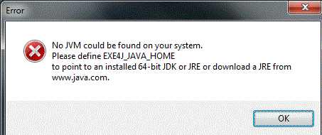

Java 7 Update 6 (64 bit) kills Serviio
I was just forced to rollback to Java 7 Update 5 for those of you who are wondering why Serviio stopped working entirely. FYI it now works fine. Please advise when a new Serviio version or java hotfix has been released to address the issue. I'm on Win7 x64 and running Serviio x64.
EDIT - To be more specific, after updating to this Java version [Java 7 Update 6 (64 bit)] the Serviio service stopped working entirely and could not be forced to start manually. As such, the console could never be made to launch and media sharing was not possible.

Problem persists with latest Java 7 Update 7 but I found a workaround for Serviio being unable to detect an installed 64 bit Java version.
When installing Java ensure that 64 bit version is installed 1st then install 32 bit version. The last two Java updates appear to be critical on installation order and for some reason Serviio can't find the 64 bit version if installed last...ODD.
Serviio error even though Java IS installed

Can you tell me if you have 32-bit or 64-bit Windows? The way it should work is:
- on 32 bit Windows, you should need 32 bit Java
- on 64 bit Windows, you should need 64 bit Java
If this is not the case it might be a bug in the Serviio installer. In that case can you post directory listing of your Serviio/bin folder?

ok. So for me this problem was related to 32bit/64bit versions of java. I have Win7 64bit and java 32 bit installed. So I uninstalled 32bit java and downloaded the 64 bit version - and woila! Now serviio works once again...

Why do you have both? Try uninstalling all Java versions, install latest 64 bit and give it a try.

Both versions, because when it's installed only 64-bit version of Java, the non 64-bit IE and other programs doesn't work properly. But I'll check it out and let you know.
[edit]
Uninstallation and installation of Java again + computer restart, helped.

Just a quick note to say that I had a similar issue with Serviio not recognising my Java install as I had 32-bit java on 64-bit windows. Looks like the "recommended" version from java.com decided I needed 32-bit because that's what Firefox told it. Having replaced 32-bit java with 64-bit everything seems to be working fine.
If you run into java issues after an install or upgrade (my error was something along the lines of "No JVM found. Add an enrivonment variable at EXE4J_JAVA_HOME or install java from Java.com") then as per zip's post, check you have the right version for your OS.
