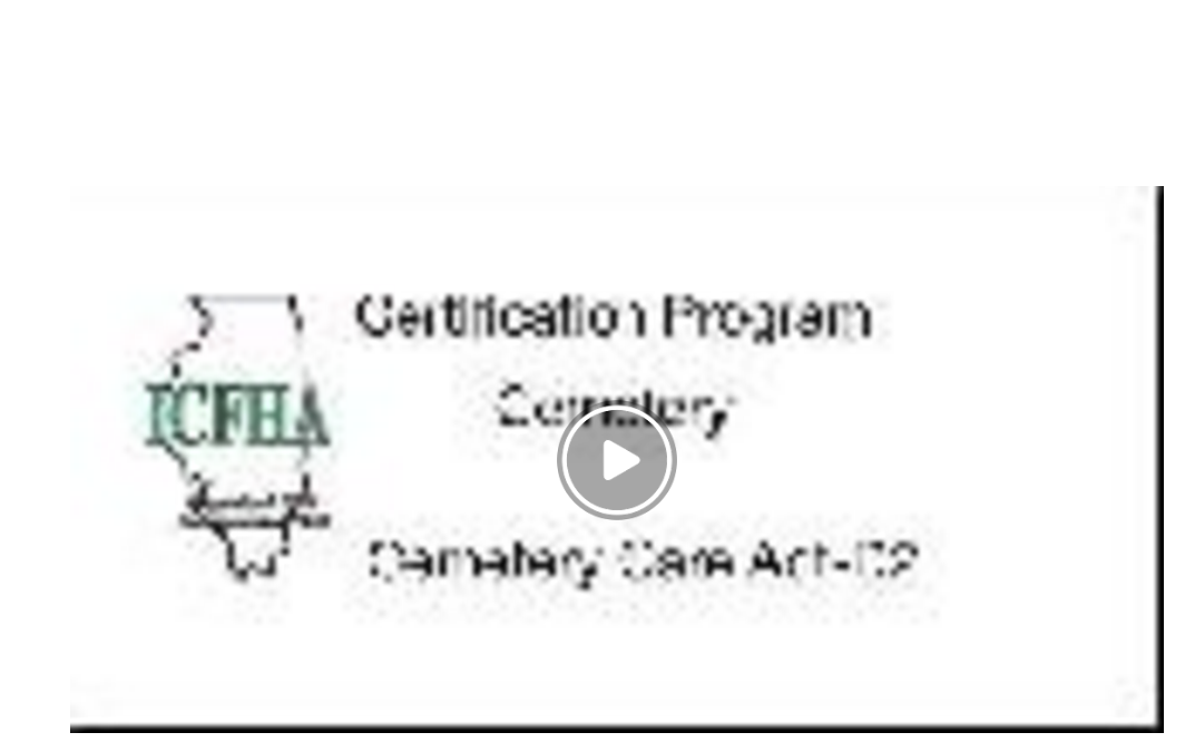

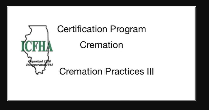

I've been creating thumbnails for my videos, placing them into a folder with the video and grabbing the thumbnail url with the restapi, to store in my database that renders HTML5 pages. The thumbnails show up correctly when the page loads, but as you can see from the attachment they are very blurry.
I've tried different pixels and jpeg and png, but the results are the same.
Thumbnail opened in Chrome
Thumbnail HTML5 Serviio
