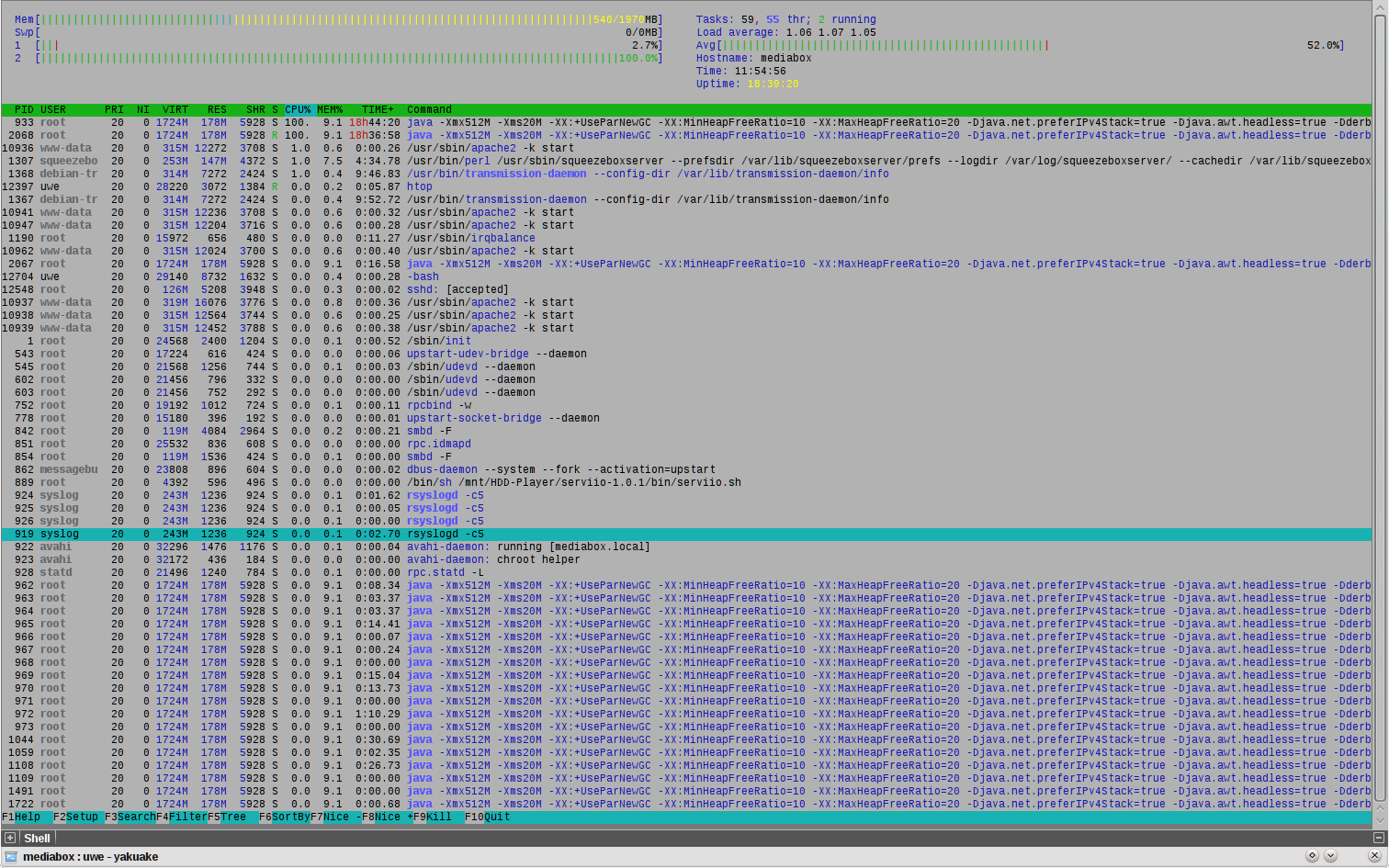

As the server get very noisy, i take a closer look at him. Under htop, i see serviio is using 100% cpu, see attached screen shot.
After going back to 0.6.2 cpu usage is at 9%.
Panasonic TX-L37EW30, Arcam solo movie 5.1, Logitech Squeezebox Touch Classic, Ubuntu Server 12.04, Serviio 6.2, Logitech Mediaserver, Huawei MediaPad

i think that depends on the different layout in top and htop. If you press H (show threads on/off) in top you will also see multiple instances of java.
