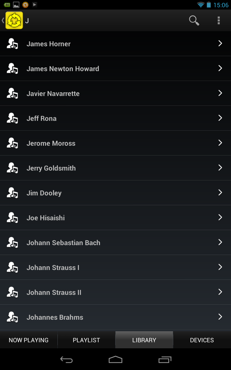

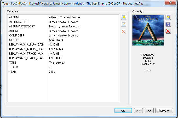

Really? When selecting the album artist category in a DLNA client (BubbleUPnP) the "normal" album artist names are shown: e.g. "James Newton Howard" under "J" instead of "Howard, james Newton" under "H" (see attached screenshots).
