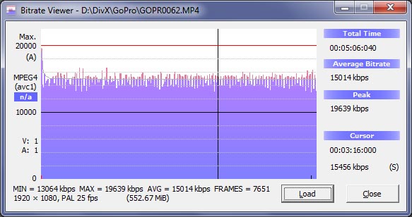

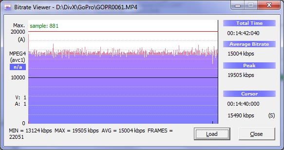

I made some captures with bitrate viewer on 3 different videos from the GoPro (all videos have same playing issues) :
GoPro Video 1
GoPro Video 2

It may not be optimal to force transcoding on all formats, but I was pissed off, and made it quick and dirty :mrgreen:
Post Thu Aug 23, 2012 6:55 pm
Re: GoPro HD Hero 2 - MP4 videos on Panasonic TX-PF42G20S
ScratMan wrote:I looked in the forum and the Wiki, and it seems I managed to kick my problem out of my TV :D
Yes this is the solution.
I suggest to keep the original Panasonic profiles and create a custom only for "GoPro" files.
If you confirm that "GoPro" media are always mp4/h264/aac then you can add this at the end of the profiles.xml
   <Profile id="custom" name="Panasonic Viera (2010) for GoPro" extendsProfileId="viera2011a">
    <!-- This is a custom profile to force transcoding with lower bitrate of GoPro media files -->
         <Video targetContainer="mpegts" targetVCodec="mpeg2video" maxVBitrate="17000" targetACodec="ac3">
            <Matches container="mp4" vCodec="h264" aCodec="aac" />
         <!-- unsupported codecs will be transcoded into mpeg-ts, mpeg2 video and ac3 audio -->
ScratMan
Joined: Sun Aug 19, 2012 10:25 pm
Post Thu Aug 23, 2012 9:06 pm
It works. Thanks. I enabled the forceVTranscoding, as is was the last thing I did on my profile to make it work, and now everything is fine.
Thanks a lot for your support. :D
