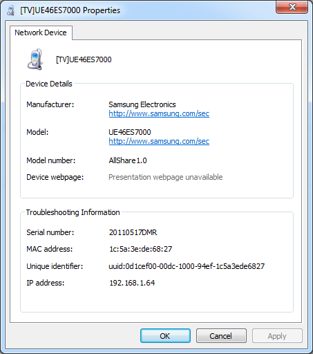

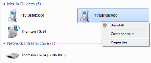

I have 7000 series. Works fine! Runn the serviio service, runn / open serviio console. Open Serviio console first tab, refresh and then klick on your tv ip aadress. (See pictures how to find a TV IP aadress under the Network Connection) After that be sure that it is a not Generic DLNA profile. You must select a samsung profile for it. If that will not help you then try to disable antivirus program and firewall. For wirst check antivirus firewall. I just had issue when antivirus was blocked a connection. From tv select source and look for AllShare Serviio with serviio logo. Thats all :) I hope that will help you.
