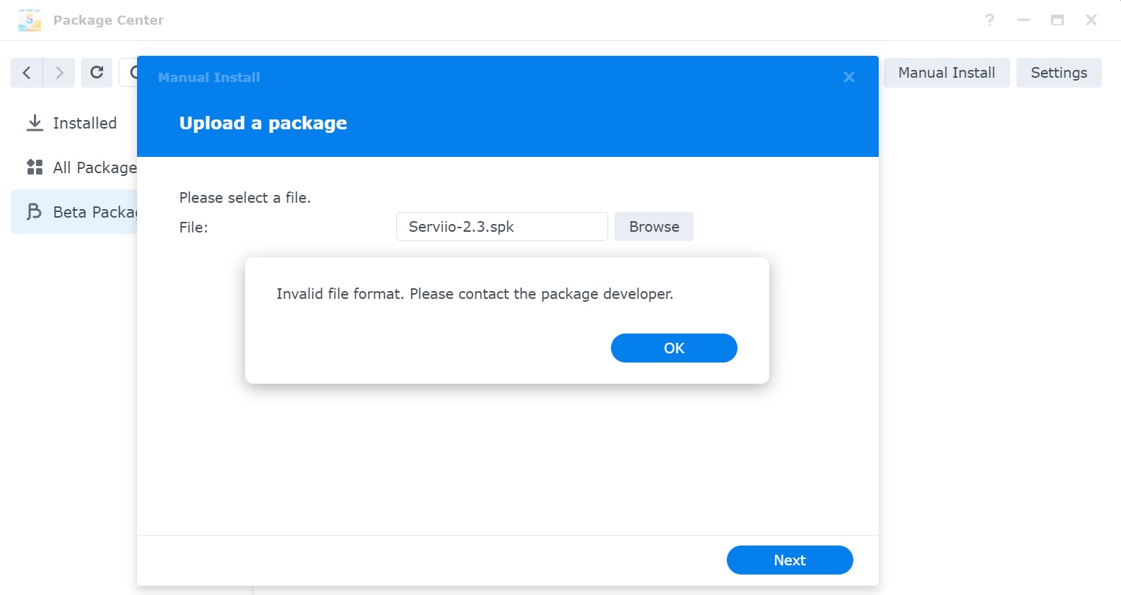

Meelis
Posts: 127
Location: Estonia
Post Sun Jan 14, 2024 4:33 pm
Re: Synology NAS (DSM 6.2) - Serviio 2.3 status
Manual install picture attached.
"Invalid file format."
Manual install
kittmaster
Posts: 195
Post Sun Jan 14, 2024 6:25 pm
I have an option, it might change the package build formatting for 7, which one did you download, zip, rar, direct?

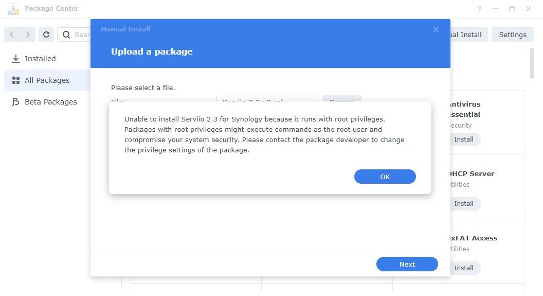

Meelis
Posts: 127
Location: Estonia
Post Mon Jan 15, 2024 9:17 am
No changes. Same result.
