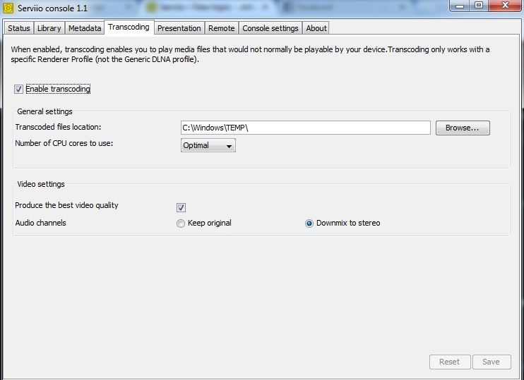

If this is to any help, here are my transcoding options:
Transcoding

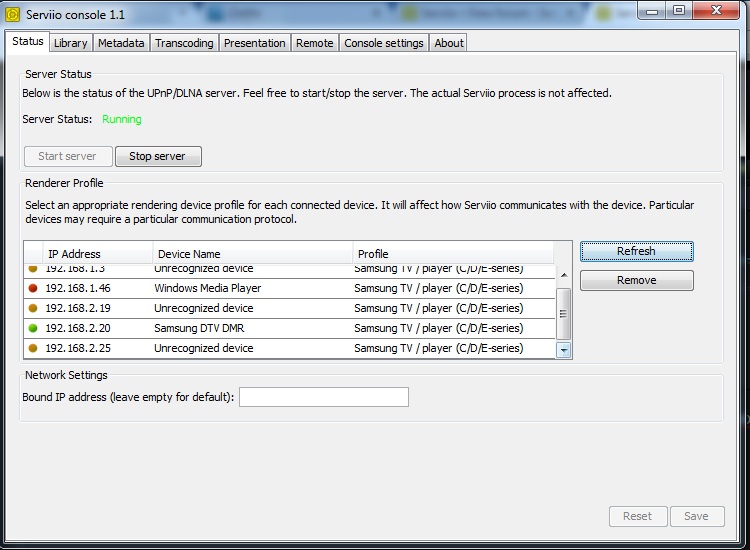

After I chance all the devices to the samsung profile, it worked. Even though its only my TV which works with Serviio.
So it might seem that Serviio has analyzed wrong and put the Samsung Device name to the wrong IP-Adress. So here is a screenshot of my Status window in Serviio.

OK, let me try to make some observations..
You have 2 NICs and Serviio uses both to search for renderers:
2013-01-06 01:41:56,920 DEBUG [RendererSearchSender] Multicasting SSDP M-SEARCH using interface eth3 (Realtek PCIe GBE Family Controller) and address 192.168.1.46, timeout = 0
2013-01-06 01:41:56,920 DEBUG [RendererSearchSender] Multicasting SSDP M-SEARCH using interface net3 (Intel(R) WiFi Link 5300 AGN) and address 192.168.2.17, timeout = 0
You have 2 subnets, .1.x and .2.xx, with the TV on .2.20 IP.
The TV responds to the search correctly:
2013-01-06 02:15:22,021 DEBUG [RendererSearchSender] Received a valid M-SEARCH response from Renderer 420b3337-bcc4-a2aa-13a2-9ec471b5ec19 from address /192.168.2.20:57360
This is what you see in the console as Samsung DVR.
When Serviio advertises itself it also uses both NICs, and the TV responds like this:
2013-01-06 02:15:24,177 DEBUG [WebServer] Incoming connection from /192.168.1.3:42144
2013-01-06 02:15:24,178 DEBUG [RendererDAOImpl] Reading a Renderer with ip address 192.168.1.3
2013-01-06 02:15:24,178 DEBUG [DeviceDescriptionRequestHandler] DeviceDescription request received for device c48120f2-ff22-3b77-88f3-f16bdd0d2e60 from 192.168.1.3 (headers = [HOST: 192.168.1.46:8895,USER-AGENT: SEC_HHP_Hjemme-TV/1.0,ACCEPT-LANGUAGE: en-us])
From there on it uses the .1.3 IP address to talk to Serviio. What is the .1.3 IP? Any idea what device it belongs to?

Ideally you want ot have the server and the devices on the same network, it might then work and use just one IP. In this case it looks like the router is interfering somehow.
