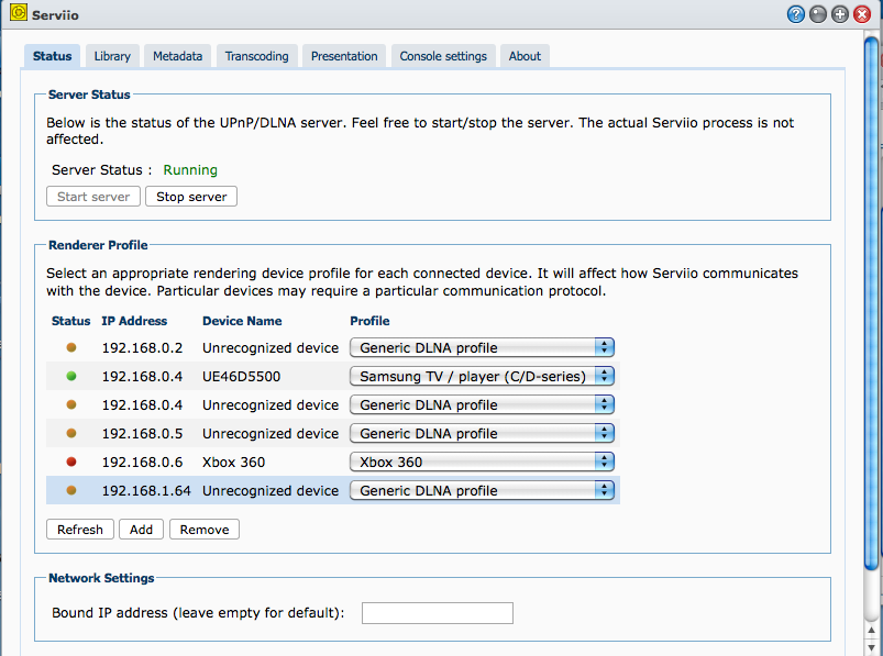

Hi All
Thanks for the hardwork but i'm currently having a bit of a headache trying to get serviio streaming To my Samsung UE46D5520 TV from the serviio server. I've plenty of 1080p DTS MKVs which when I try to play on my Samsung just say "Not supported File Format". My Standard definition .AVIs play absolutely fine. My Server is a Synology NAS DS212j and ffmpeg output of one file is here:
DiskStation> which ffmpeg
/usr/syno/bin/ffmpeg
DiskStation> ffmpeg -i 9\ \(2009\).mkv
ffmpeg version UNKNOWN, Copyright (c) 2000-2011 the FFmpeg developers
  built on Mar  7 2012 15:59:03 with gcc 4.2.1
  configuration: --arch=arm --target-os=linux --cross-prefix=/usr/local/arm-none-linux-gnueabi/bin/arm-none-linux-gnueabi- --enable-cross-compile --enable-optimizations --disable-yasm --disable-altivec --enable-pic --enable-shared --disable-static --disable-swscale-alpha --disable-ffserver --disable-ffplay --enable-libmp3lame --enable-libfaac --enable-nonfree --enable-version3 --enable-libopencore-amrnb --enable-libopencore-amrwb --disable-decoder=amrnb
  libavutil    50. 40. 1 / 50. 40. 1
  libavcodec   52.120. 0 / 52.120. 0
  libavformat  52.108. 0 / 52.108. 0
  libavdevice  52.  4. 0 / 52.  4. 0
  libavfilter   1. 77. 0 /  1. 77. 0
  libswscale    0. 14. 0 /  0. 14. 0
[matroska,webm @ 0x33f20] Estimating duration from bitrate, this may be inaccurate
Seems stream 0 codec frame rate differs from container frame rate: 180000.00 (180000/1) -> 23.98 (24000/1001)
Input #0, matroska,webm, from '9 (2009).mkv':
  Duration: 01:19:24.25, start: 0.000000, bitrate: 1536 kb/s
    Stream #0.0(eng): Video: h264 (High), yuv420p, 1920x1040 [PAR 1:1 DAR 24:13], 23.98 fps, 23.98 tbr, 1k tbn, 180k tbc (default)
    Stream #0.1: Audio: dca (DTS), 48000 Hz, 6 channels (FL|FR|FC|SL|SR), s16, 1536 kb/s (default)
DiskStation> pwd
/volume1/House47/Movies
DiskStation>

So, to me it looks like it's trying to play using the generc DLNA profile.
I've noticed I've got 2 recognised connections for the TV (please see attached screen shot)
I've tried deleting the non samsung one but it just keeps coming back, i've tried stopping / starting the server...any other ideas at all?
Screen shot 2012-04-12 at 23.16.08.png (125.66 KiB) Viewed 15314 times

that is weird, not sure if it's a bug in the UI or the server (the fact that you cannot delete it). Try to remove both .4 entries and retstart serviio.

Yeah tried that - even if i delete all devices, stop the service then load the GUI back up again the devices all reappear.
I really think it's becuase I use DHCP and the Samsung telly now has the address another device (probably my macbook) had which i was using to test connectivity when i initially installed serviio.
I don't think its anything uninstalling and reinstalling the whole package won't cure but before i do that I might try to get the attention of patters, the chap who wrote the package, see if the there's anything i can hack to get shot of those devices.

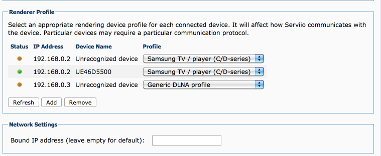

Screen shot 2012-04-14 at 10.43.32.png (60.12 KiB) Viewed 15278 times
Hi
Just to tell you all its fixed. I've set my devices to get the same IP address from my router and uninstalled and reinstalled serviio on my NAS. I now still get 2 entries for the samsung telly (same ip addresses) but now when i change the one which defaulted to the generic profile to the samsung profile the change sticks and it doesn;t revert back to the generic profile like it kept doing before - i still can't delete one of them though. I'm seeing the same behaviour through the client itslef on the NAS and the web Client.
Anyway, I don;t really mind. Alls working really well - everything I've tried so far plays. Very happy with it - thanks for all your hardwork in making this a great little media server.

Hey, great post and follow up with resolution. I've been suffering with the same problems for the past couple of months, but this has allowed me now to play .mkv format.
I wasn't aware that the profile was selectable from a drop down, or that the erroneous devices that appeared in the list could be deleted.
For the record I have a UE32D5000 with a fixed IP, which appeared twice in the list of devices, plus two other PCs (Ubuntu). I deleted the three incorrect devices and changed the profile of the TV and now I can play .mkv files. Serviio is running on a Xen VM (Debian Squeeze).
