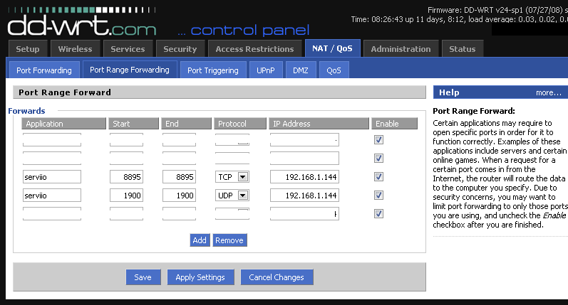

Ny Network:
DHCP behind a linksys router running DD-WRT. All ports opened as indicated in my original post, screen shots in attachments. Media server PC is IP 192.168.1.144 which I am binding to serviio. I see that Serviio sees my TV, as the log shows the TV's IP (192.168.1.126) as the renderer. Let me know if you need more detail on the network.
When I connect to the Serviio device from my TV, all I see is a folder named Audio, with a subfolder Artists, both folders are empty of files (I am not sharing a folder called audio or artists). The log shows the video files discovered in the shared folder, but I dont see them in the DLNA interface on the TV.
I wasnt sure how much logging you wanted, so I let it go for a few minutes. then shut down the service. Please let me know if you need additional info, I'd love to see this working. Thank you for your help and time.
something else just occurred to me... I have UPnP disabled on my router. Is it absolutely required for Serviio? I wouldnt think so, but figured I should mention it.
Port Forward screen shot 2
5-11-2011 11-26-23 PM.png (24.29 KiB) Viewed 27961 times
Port forward screen shot 1
5-11-2011 11-26-09 PM.png (24.4 KiB) Viewed 27961 times

I did not have to forward any ports on my router. Do you have windows firewall enabled? If so open the ports 8895 (TCP) and 1900 (UDP) there. Do you have any other computers, or xbox 360 or playstation in the house that you can make sure that the computer on which serviio is installed on is working properly for streaming the movies. Run the following command and let me know what it say. You will have to run it in a command window. If you do not know how type cmd in the run box and then run this command in it.

Well this problem is resolved. I turned on UPnP in my router, and the files show up. I didnt want to turn it on, as I thought there were security concerns around having it on. However, it might be clearer if you indicate that UPnP is absolutely required. Not sure if I will go with Serviio due to the reliance on UPnP. Thanks for the (little bit) of help.
