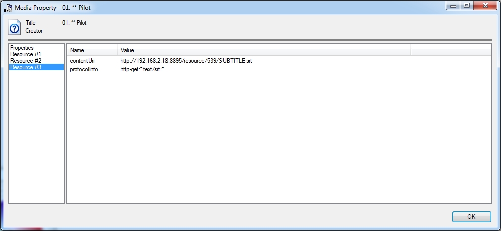

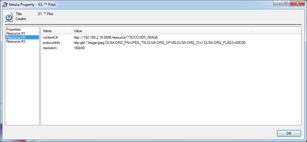

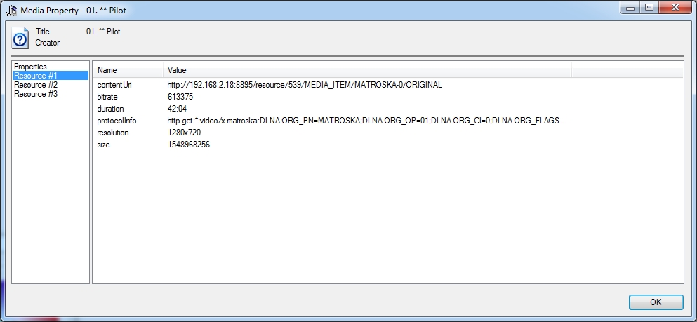

3. Using Intel "AV Media Controller" I see the subtitle resource.
I understand from another threads that the TV need to open a new connection to ask for the srt file. That is correct? I don't see this request on the log.
4. From another threads I understand that the subtitle file will be the resource #2. In my case is the #3. This is a problem?
This are the AV Media controller screen for the file:
resource1
resource2
resource3

Looks ok to me. If the incoming requests use a Viera profile and don't ask for the srt resource, not much we can do. Maybe it doesn't srt for MKV files? Did you try it with an avi file?
