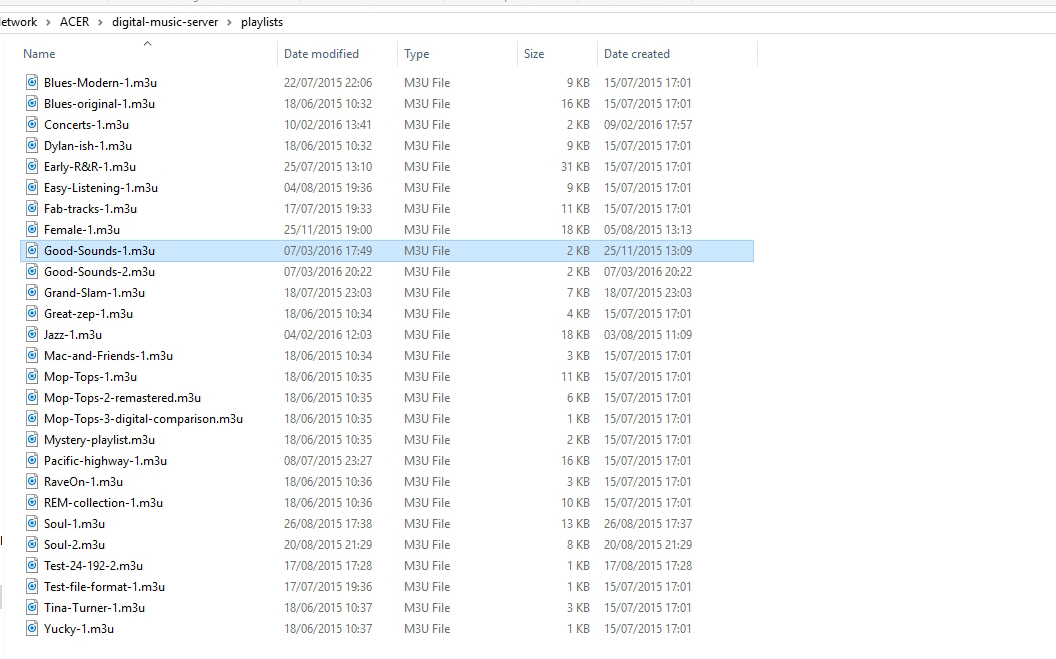

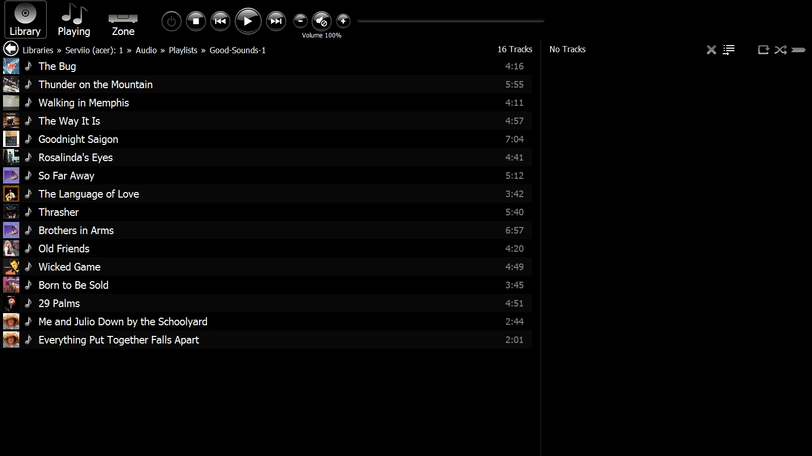

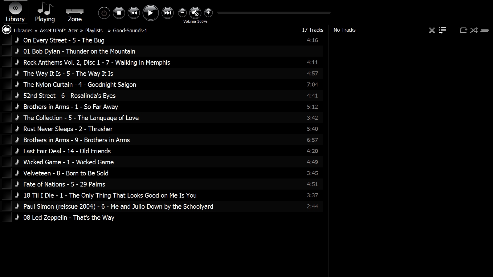

In the meantime I enclose screenshots. The last file was removed and an additional file added at end of playlist.
The change (Good-sounds-1) was made at 17.49 and still not updated after 3 1/2 hours.
The audio file has been there for 9 months (also other server updated OK) - see screenshot. (Files are selected from pull-down list in M3U Creator).
I have now noted that new file Good-sounds-2 has not appeared (it used to under earlier versions - that is how I got around the issue previously).

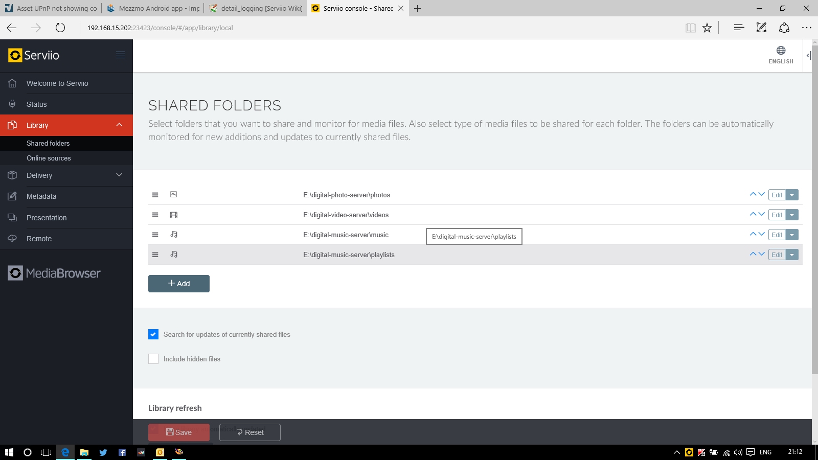

I thought the developer has resolved this issue or by setting the "Use the poller mechanism for monitoring this folder" option under shared folders/edit for the shared folder of the the playlist folder as at 1.9.1.
