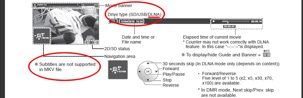

gabychou wrote:My TV set is brand new and fully compatible with subtitles (VT30E is the lattest and top Panasonic model)
There are differences between models (and region/country where purchased), but the software which reads the various video file formats is similar. See owners manual for notes on various file formats. For example, from VT30 manual:
from VT30 owners manual pg 32
Peter

PMI
Posts: 156
Joined: Tue Jan 03, 2012 3:32 am
Location: Milwaukee, Wisconsin
Post Wed Apr 04, 2012 3:02 pm
Re: Why is it mandatory to embed subtitles in container?
It looks like you are using the generic DLNA profile (?) That may be part of the problem. I am not even certain the generic profile supports srt files. Cerberus made two new profiles for Viera models sold 2011 and later.
You should probably add one of the new Viera profiles to the Profiles.xml file before doing any more testing. The new profiles have not been tested by anyone with your Viera model (at least nobody who posted results). However, based on what you posted so far, I think you should use the Viera Profile for sets WITH AVI support, because I believe that should work for any recent Viera set sold in Europe. This is the profile voodooo tested and worked for him.
Peter
Panasonic Viera TC-L32E3 LCD | Panasonic DMP-BDT210 | Windows 7 |

Post Thu Apr 05, 2012 3:15 am
Looking at the excerpt of the log file, I only see references to "Generic DLNA Profile". see highlite:
2012-04-03 22:11:41,997 DEBUG [VideoDeliveryEngine] Delivering item '20177' for client 'IPAddress=/192.168.1.2, Profile=Generic DLNA profile'
2012-04-03 22:11:41,998 DEBUG [VideoDeliveryEngine] Delivering file 'Freedomland.avi' in native format
Perhaps the Viera Profile was not selected at the time of the test (you have to do that manually in the Serviio Console, and then click the "Save" button). Mind you, this is just a guess, but the excerpt of the log file has no trace of any Viera profile... :?
Peter
